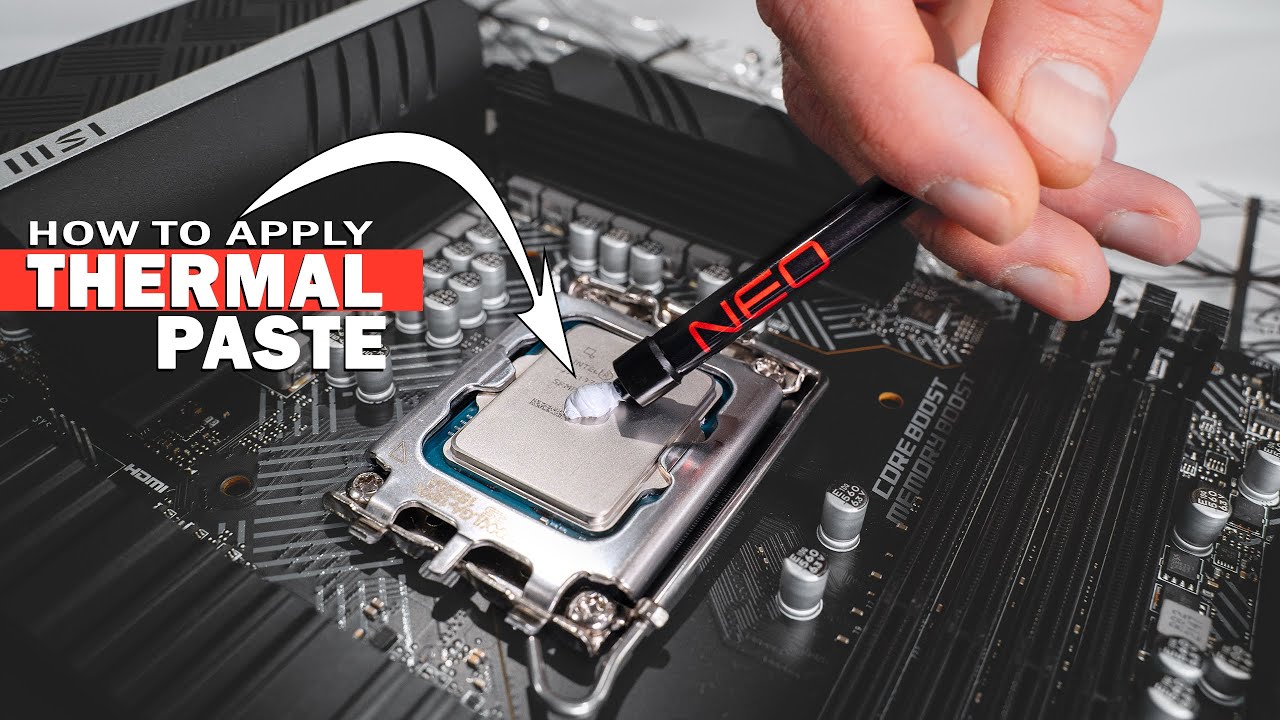

Now listen, both your CPU and GPU use something called thermal paste and you have to replace this thermal paste after about 5 years cause the thermal paste drys out and cracks and just isn’t effective anymore. My PC is 10 years old and I’ve never replaced the thermal paste on my CPU so I’m going to do that here very soon and that should probably increase the performance of my CPU by a significant amount, especially during the hot summer months which we are about to enter. I don’t have air conditioning (can’t afford it) This is the thermal paste I got off Amazon Amazon.com
I replaced my nvidia GPU with an AMD GPU just a few years ago so I don’t need to replace the thermal paste on my GPU just yet. Linux gets along a lot better with AMD GPUs.
