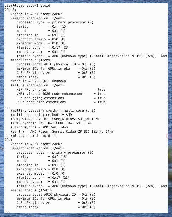

Never mind “cat /proc/cpuinfo” for now. See: /proc/cpuinfo versus cpuid (written just now).
Instead, try using cpuid (which gets the information directly from the CPU):
cpuid usage
Then compare using CPUID Spoofing Testing (written just now).
I don’t see a lot spoofing there. It might make you stand out more unless you could come up with a way to spoof more information.
I can certainly do some more spoofing, like reporting a Pentium D. But it’s pointless, you don’t need CPUID to detect some features.
You mean that all CPU spoofing attempts are currently futile? I’d agree.
